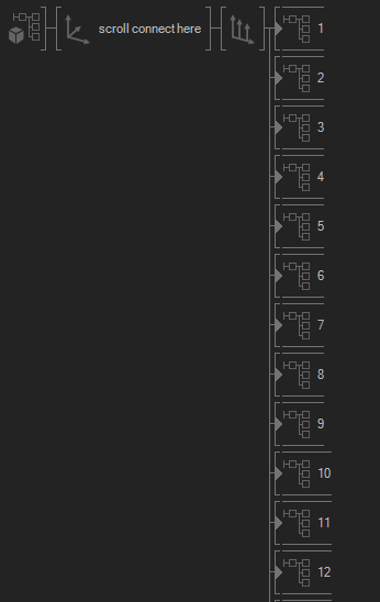

One of the solution is to create a Container with Text connected only to one of the cell from an excel spreadsheet.
Put all of them under Arrange node.
Create a logic that calculates the height for each cell to adjust the scroll each time when you add a cell with the donors name. You have to block block Container when cell is empty.

Maybe you can have a look inside the manual looking for
"Arranger" (as Agalar already said), "Layout" and "Ticker".
So you don't need the scroll text node
Just arrange normal 2D Block Texts and let them scroll with the ticker....
