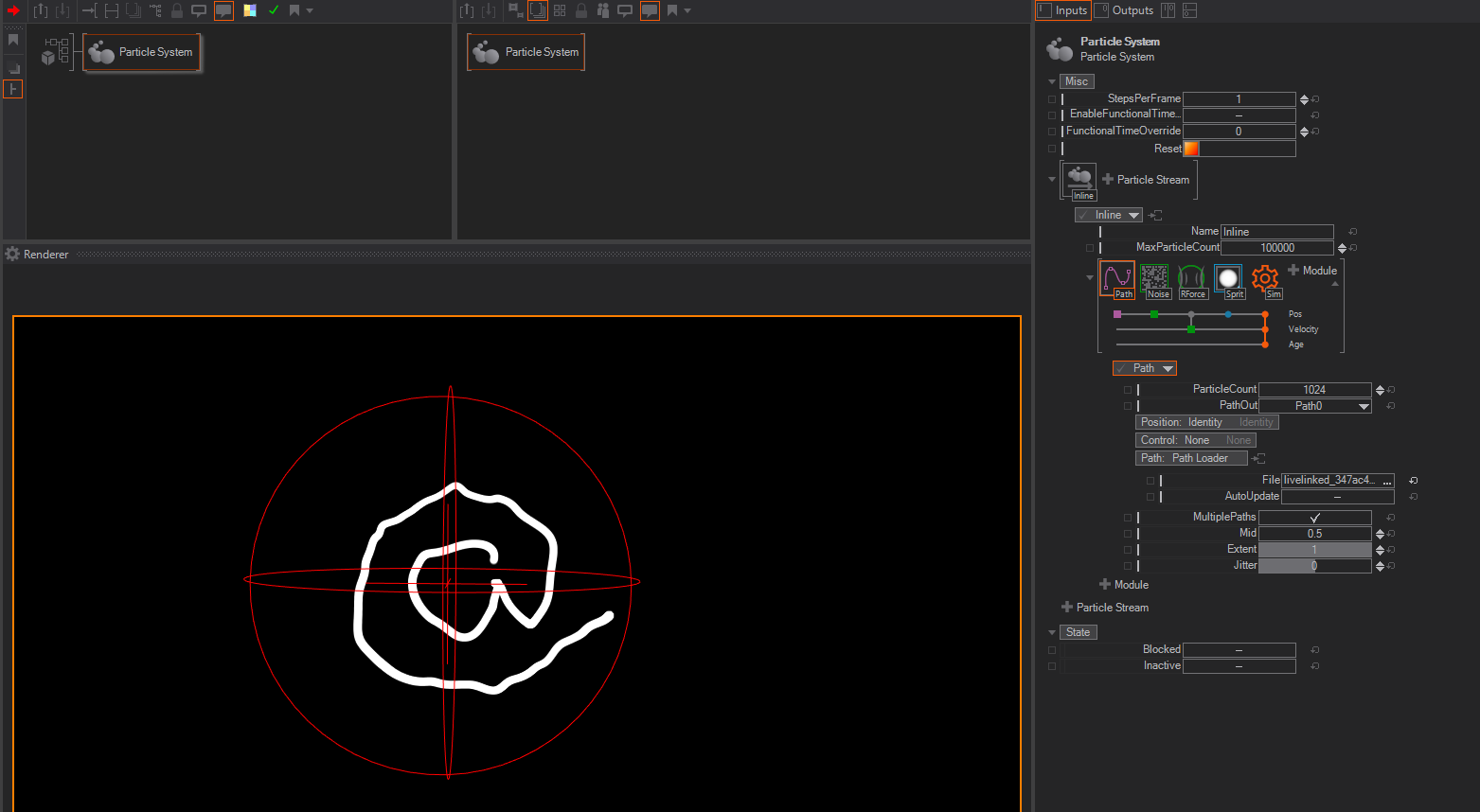

You can create a Particle System with a "Path Emitter" and use the Spline there as well. Simply create a Particle System and add a "Emitter Module called PATH"
Load the "VPATH File" and select "Ventuz 3D Path"
Find it in the Geometry folder and select the correct VPATH to be loaded
Now you can make use of the loaded VPath Emitter. USe it as a secondary stream or simply as it is
