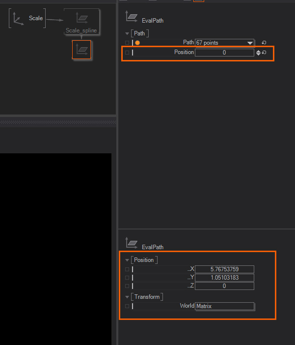

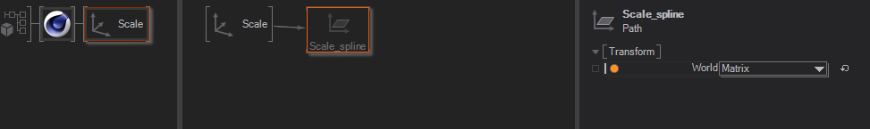

How to get Splines in Ventuz:

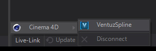

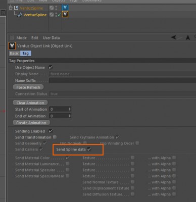

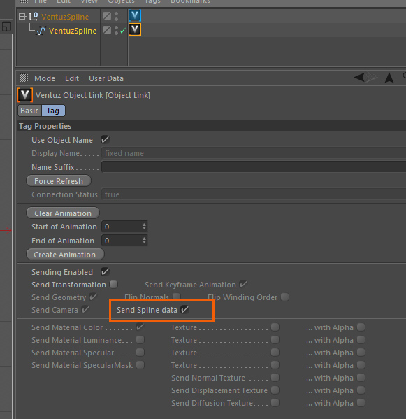

1. Create a path with the spline tool in C4D and use the Ventuz Tag to send the Spline Data (should be enabled per default already)
2. Use the Geometry import live node to import that path into Ventuz
3. The result will be an axis and the content will have a path node linked

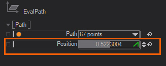

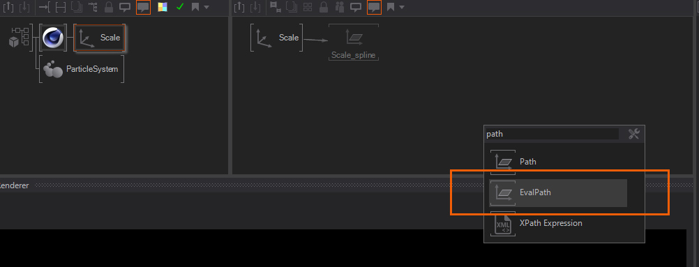

4. Use the EvalPath node and bind that that to the Path
5. The EvalPath will output XYZ position and a Worldmatrix. Both could be used to animate Objects along the path, you can use the Position Value to define the position along the path

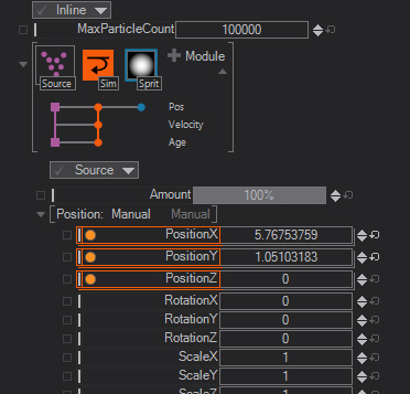

6. Use the "Position: Manual" to bind the X/Y/Z axis to the EvalPath node
7. Animate or scrub the Position value for the EvalPath to change the Position along the path
