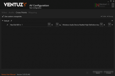

Hello,
Is it normal ?

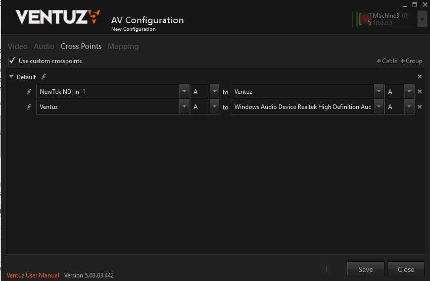

This setup works

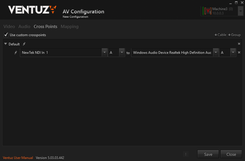

Not this one

Yes
You don't create a chain. "To Ventuz" means use as input (for instance to use with the FFT node). If you want your NewTek as input to Ventuz AND as output to your speakers, you create two:
NewTek TO Ventuz
NewTek TO Realtek..
cheers,
rou
NewTek TO Ventuz
NewTek TO Realtek..
cheers,
rou
