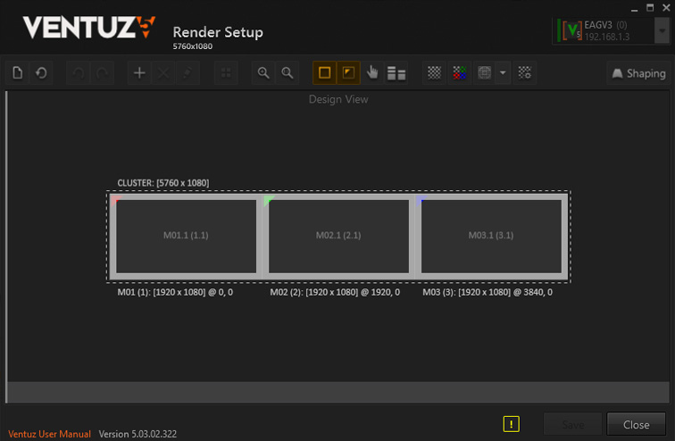

I have 3 seperate Machines.. each one outputs 1920x1080 resolution .. and are aligned next to each other (configuration.jpg)

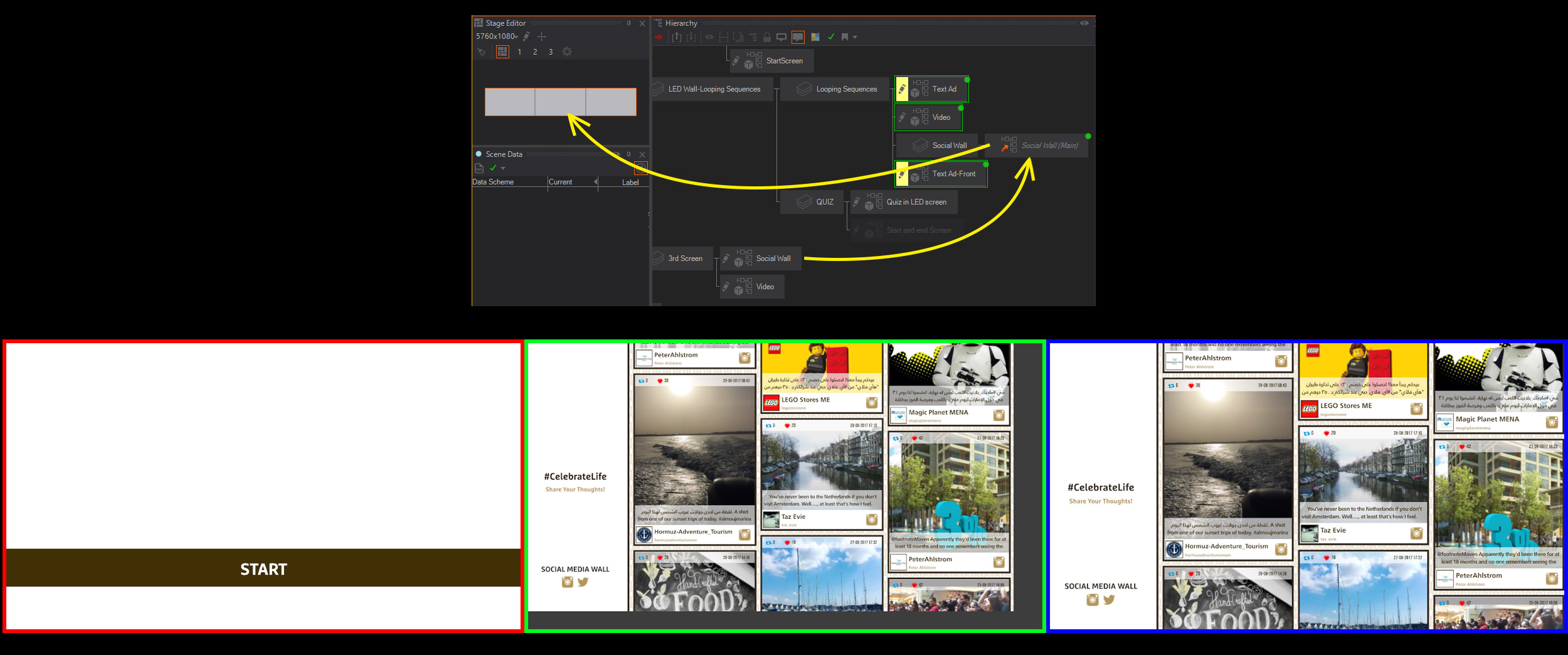

On My Cluster preview (Cluster Preview.jpg) .. I can see everything perfectly fine: I have a 3D Layer reference on the 2nd Machine (which is in the center), while the layer it is referencing is on the 3rd machine (furthest right output)

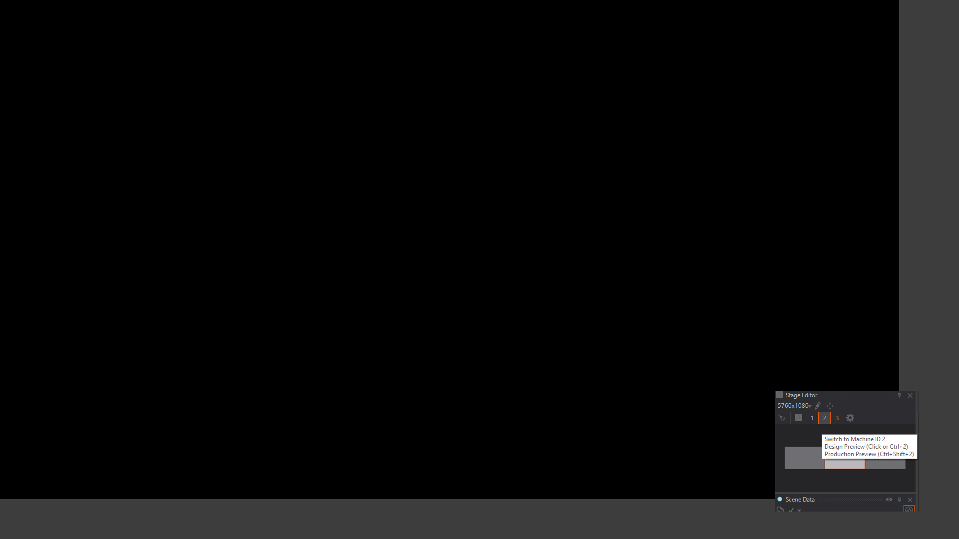

the issue happens when I Select My Second (Middle) Machine preview from the stage editor, The Layer is completely blocked (Screen 2.jpg).
