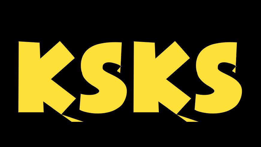

I'm using a font called Soup of Justice. Available for free here - https://www.ffonts.net/Soup-of-Justice.font
I'm getting render errors on the letters K and S. I've attached an example of the output.
I'm using 5.1.1 but have verified the problem still exists in 5.3.
Font Render Error

Hi!
Thank you for the report. I will create a bug ticket for that.
In the meantime you could disable the 'High Quality 2D Text Rendering' in the Machine Configuration to overcome this problem.

Re: Font Render Error
Can you direct me to where that setting is located? I must be overlooking the obvious.
Took some digging, but I finally found it.
