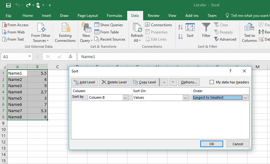

I would recommend a really simple alternative. Bind the Excel cells with the names fixed. First row in Excel is first row in Ventuz, 2nd is 2nd, etc. for all your names.
Go into Excel. You will be editing it anyway. Select all your names and values. From the Excel Data menu select Sort. Select which Column you want to sort by and the order of the output. Click OK. Press Save and Ventuz is updated as well.
Attached is a screenshot of Excel with the Sort menu open. Super simple and quick. No logic required in Ventuz.
Hope that helps to solve your problem.

Thanks Christian ,
but i need to do the sorting thing in ventuz not in excel.
