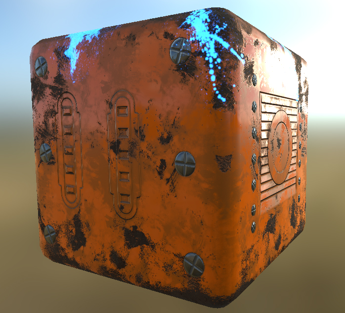

I hope you enjoy the Presets and the DemoCube. The Material on the DemoCube is a standard "shipped with SubstancePainter" Material, which is just altered in the color.

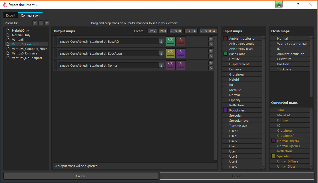

Ventuz5_Compact:
This preset will create "compact" textures. This means you have to manually map the channels inside of the material node. For example:
The "BaseAO" will have the BaseColor in the RGB channel while the AO is inside the Alpha. If you import that texture in Ventuz you should map the Alpha->BaseColor, Multiply.
The compact textures will save a LOT of your materialstages and do not waste the alphas. very handy .. not?

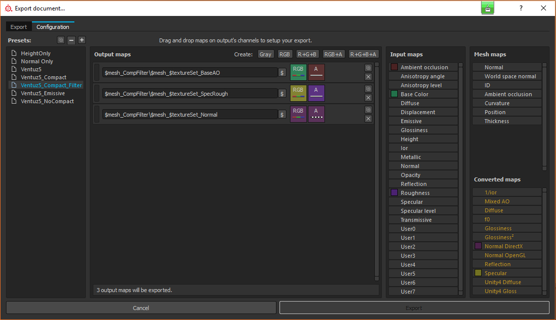

Ventuz5_Compact_Filter:
This is a special set, basically its the same as the "Ventuz5_Compact" but has and can be used with a "baking light filter" .. watch this:
