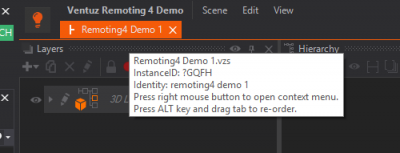

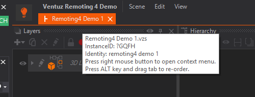

Kinetic Pixel are finally moving ahead with our migration to Ventuz 5, and we've ported our old Remoting libraries with some success so far. One thing that's confusing me though - When running a scene in designer, the IID I get back from Remoting in the FlaggedIID object is different to the one I see in the tooltip when hovering over the loaded scene in Designer.
Is there any significance to this?

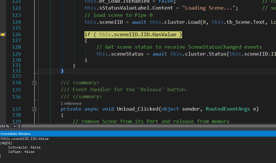

Thanks for the reply. I'm seeing the same behaviour running the Remoting4 Demo 1 application too - see screen grabs below. Again, I can close the scene in the designer, and still the renderer shows the loaded scene and I can still control it.
I'm running Ventuz 5 Designer and Visual Studio on the same machine, if that's relevant.

As I already said: your are comparing a scene loaded via Remoting with a scene loaded with Designer! These are two different scene instances!!!
The Demo works as follows:
- open Designer
- do NOT load any scene with File->Open
- start Demo and Press Connect & Load buttons until the scene appears in the Render Window
- open the Scene Tree to see which scene are loaded and which IIDs they have

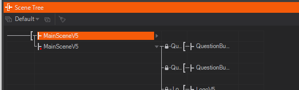

OK - the Scene Tree is something we've not had to use before. This is all making a little more sense. I can see by stepping through my code that loading/validating the named scene creates it in the scene tree, but does not map it to a port. Activating the scene does that, and if I follow your pattern below then I DO end up connecting to the same scene instance as the one in designer. Looking at the scene tree, I was ending up with this situation -
So as you said, I was connecting to a different instance of the scene. Two questions arise from this however -
