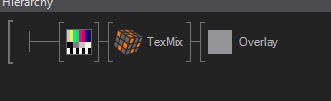

Just thought.. you can also do some colour correction with the matrix nodes, for example you can use the Texture Mixer to adjust RGB:
- Capture.PNG (3.17 KiB) Viewed 4086 times
