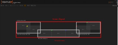

Playing full resolution movie is performance killer when screens are not aligned. Maybe you could introduce an "output aligned" state near the "screen aligned" one.
A specific folder structure for presplitted movies could be natively supported and recognized in Director too for drag and drop purpose.

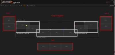

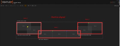

2. There is no way to automatically position texture fulfilling the output as in my 3rd screenshot. This is more performant because you need in this case just a 2xHD resolution movie instead of a 3347x1621px one like in my 2nd screenshot.

We have this on the road-map but it's currently not decided if we can provide the necessary features/tools still in Ventuz 4 or in Ventuz 5.
