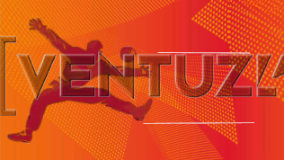

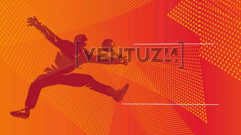

I double check. The bug is really here
Here's snapshot output attached
and source code in vb.net
remotingQH v3 test snpashoot.zip (3.2 Mo) http://f.laboiteaslides.fr/89c8a/
Florian

Hi Florian!
Are you confused by the fact, that your snapshot is sometimes smaller than the specified 'width' and 'height'?
This happens because the snapshot image is not scaled up.
So if your Renderer has an output size of 1024x768 and you call Snapshot(0, ImageFormat.PNG, 1920, 1080, Nothing, Nothing, Nothing, Nothing, Filter.High, True, yop)
you will get an image of size 1024x768.
If your Renderer has an output size of 1920x1080 and you call Snapshot(0, ImageFormat.PNG, 1920, 1080, 0, 0, 960, 540, Filter.High, True, yop)
you will get an image of size 960x540.
Is this your problem?
