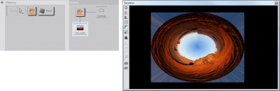

Yes, joysprod is absolutly right! Here is my example in vvvv

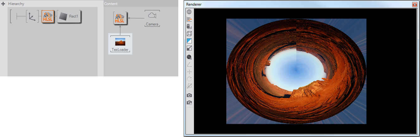

Ok... i just asked because thats exactly the output your posted shader produces.
You probably did not set all needed input values properly. The Shader need a Texture and a Matrix. The texture comes from a Texture Loader of course. I took a Camera to provide a standard ViewMatrix to the shader.
MipMaps can produce unwanted effects here, so try to set GenMipMaps to False on the TextureLoader.

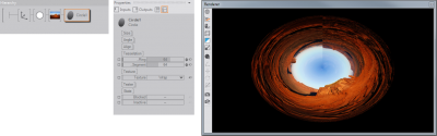

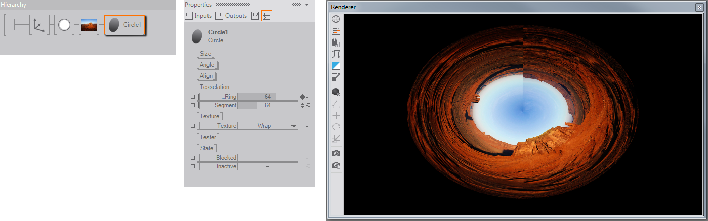

You can achieve almost the same result without the need for a shader. Just take a Circle and set the Texture from Flat to Wrap. You need to increase the Tesselation to get proper results. Plus, i needed to adjust the Scaling of the Texture Mapping to -1 because the texture was mirrored. If needed, scale the Circle according to the aspect ratio of your texture.
The result is the same, but without the distorted parts that are not part of the picture anyway.
