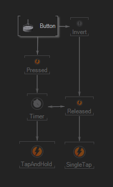

I extended the touch button with 4 nodes to make it very reliable for most touch devices.
The bottom two events are optional, important are 2 events with their shot connected to touch.pressed, one of them going through an invert(logical).
event.pressed starts a reverse timer (start.time defines TapAndHold minimal duration), the timers elapsed event is your TapAndHold.
The released.event.enabled is connected to timer.running, and its output is your SingleTap, this also resets the timer.
The benefit of this is not only an better Tap recognition (if touch started on button and is moved outside before release, it will still trigger) but also that the SingleTap behaves like most UI buttons (trigger on release)
