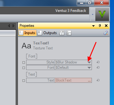

Hi all,
I found an issue in my interface
It's really difficult to open the font style menu. The picking area is restricted to 1 or 2 pixel.
I indicate exactly where works, two pixel more to the left or right the menu doesn't open.
one pixel area pick menu

I cannot confirm that problem. First time I ever hear about that one. That seems to be a problem only on your machine.
Did you change the default DPI settings in "Control Panel\Appearance and Personalization\Display"?
Do you use a non-standard mouse with custom control software?

Cannot confirm this neither!
If this would be a general problem we would already have lot feedback about this because the use of text in Ventuz is essential!
Cheers
Cheers

hi karol
a problem we had in the past:
we switched the resolution from 1920*1080 in the catalyst driver to portrait mode....now ventuz didnt get the original position of the nodes in the gui! you have to click beside of the node to mark it or to make any connection!
greetz
christian
greetz
christian

I did another test.
I enlarged the Properties windows. The tiny black arrow now opens the style menu, but If I reduce (stretch horizontally) to the minimum this window and the tiny black arrow is close to the monitor edge I'm not able to click and open the style menu anymore, except I found that small 2 pixel (about) area.
All the other tiny arrows below open the menus.
I tried on another machine and it works always in both cases enlarging or reducing the Properties window.
The two machines have the same mouse and monitor (2560x1440), the first one has Titans, the second one GTX580s.
Strange behavior but it's ok because enlarging the properties window now I can open the style menu normally.
Titan's bug?
Regards
Titan's bug?
Regards
