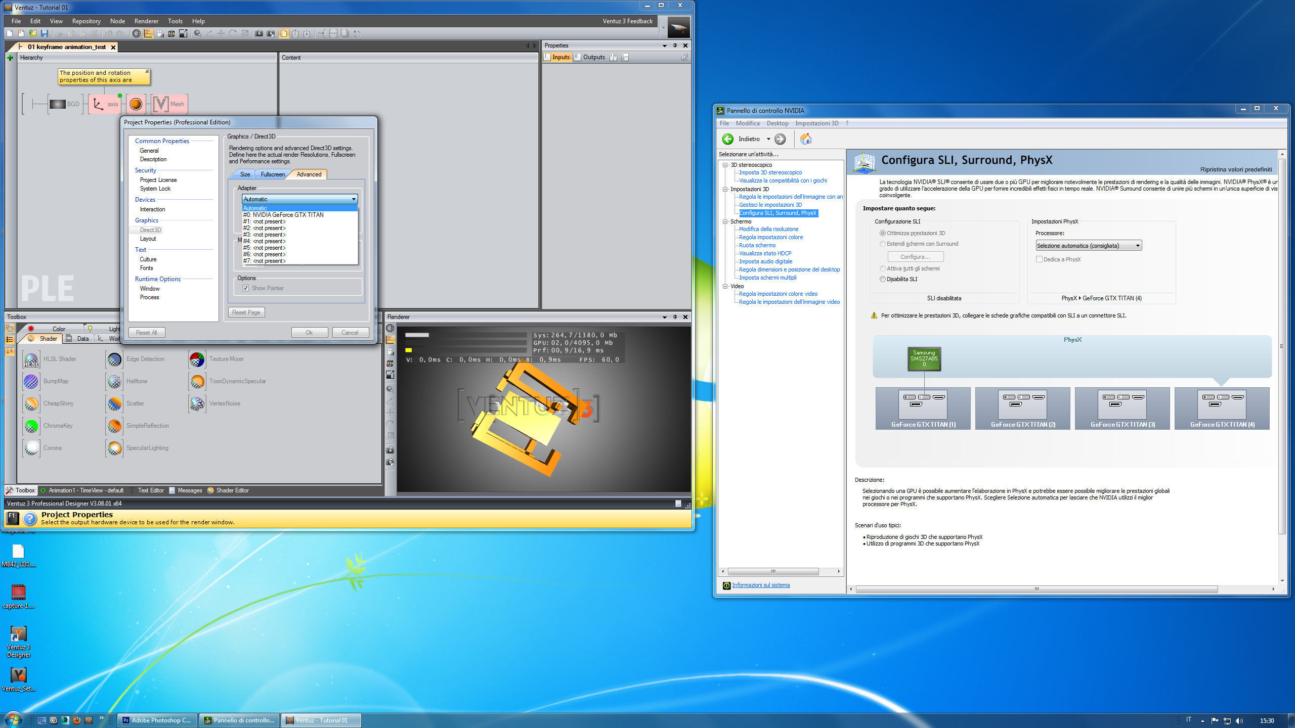

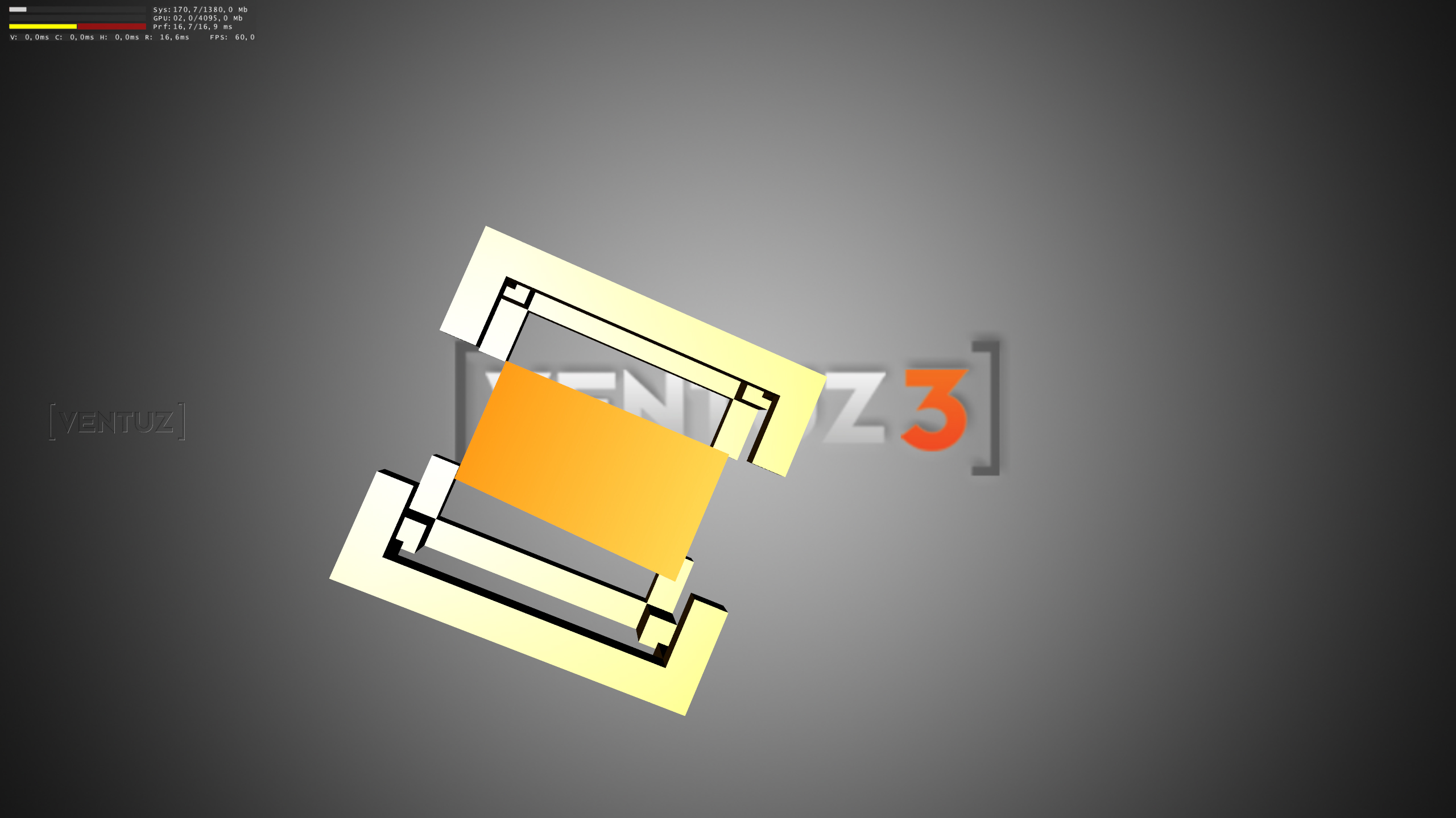

Hi Christian
I did all the necessary tests with no luck
It's strange that Ventuz sees only 4096Mb of vram. Titans have 6GB
I grabbed two print screens
At full screen sometime the performance bar is red
I think that my system is too much complex or Nvidia driver aren't optimized or Ventuz doesn't like Titan board.
I don't worry about performance because If I will buy Ventuz I will assemble a simple machine with the Ati card, I read in the forum that Ati gpus work better.
Regards

Christian Krix Schmidt
- Posts: 290
- Joined: 18 Jan 2012, 11:36
Re: jerky 3d animation?
See, that is funny, I consider nVidia cards to be superior and only use nVidia cards in my projects.
The performance info/bar in Ventuz3 is no longer up to date. They changed all that with Ventuz4. The statistics are showing all available RAM in Ventuz4.
Your scene is so incredibly simple that there shouldn't be a problem. Maybe it is actually too little and the nVidia cards are not doing enough. I think a few years back there was such a case when the card was not performing well because it had too little to do. Not sure anymore. What happens if you add objects. Or simply add a spreader in front of the obj and duplicate it a few times.
By the way, you seem to be evaluating Ventuz3. But sadly at the very end of its life cycle. Ventuz4 is coming out very, very soon and has a lot of changes, both visually and internally. You seem to want something very specific and can't decide to use Ventuz or not. I don't know why you just not simply use it because it does work as advertised but in any case I would wait for Ventuz4 and then do you tests. The software has undergone some major improvements and enhancements and if you wait until the end of the Ventuz4 lifecycle to test it you will truly miss out on something.
