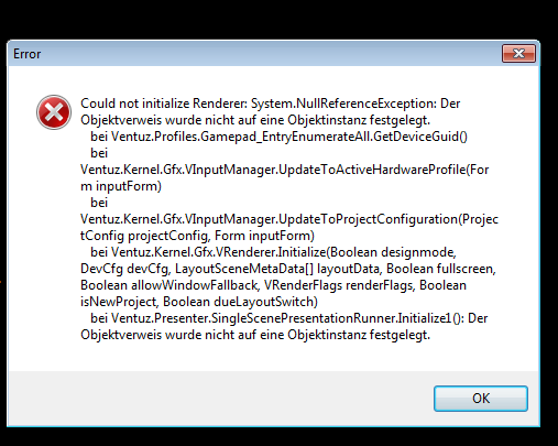

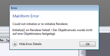

Meantime I always get this message on init ventuz. No Render Window... Any idea?
This post could be related to "How to..", if so pls relocate.
Initialize() on Renderer failed!
Re: Initialize() on Renderer failed!
Last week it worked! After reinstalling Ventuz there is still no successful render window init.
Reason: The error appears if gamepads are in machine cfg and are disconnected from pc.
