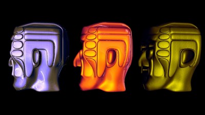

Re: Shader Thread
Kind of dual-layer metallic shader - taken from ATI demo.
Your geometry needs proper UV coordinates!- Attachments

Re: Shader Thread
hey karol
very nice! THX
greetz
christian
very nice! THX
greetz
christian
