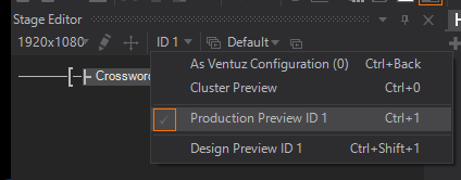

try opening the Stage Editor in Designer (View->Stage Editor or Ctrl-F12). Click on "ID 1" (the 1 depends on your machine ID) and select Production Preview.
Cheers,
rou
Cheers,
rou
- se.png (6.18 KiB) Viewed 5557 times

Hello Rou,
thank you a lot, that was exactly what i needed, i guess there are still a lot of places that i need to find out
, thank you again.
