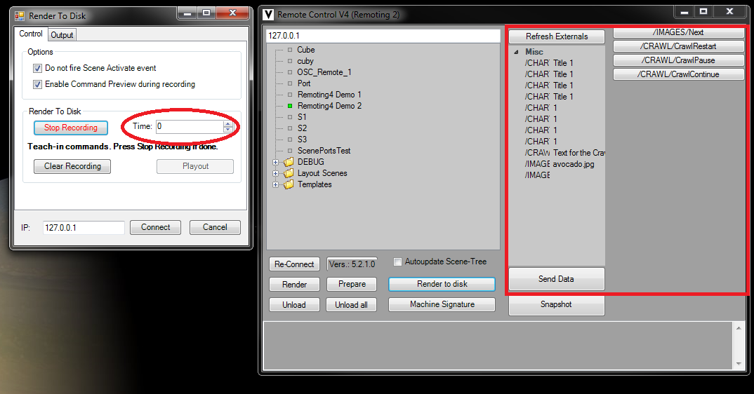

To try it out start Designer or Runtime (Runtime needs the Remote R2D Option);
'Connect' with the client and load a scene;
click 'Render to Disk' and 'Connect' in the R2D dialog;
configure the recording options;
press 'Start Render2Disk' until it looks like in the screenshot;
adapt 'Time' and trigger Events or send new data/properties -> change 'Time' and send new data;
press 'Stop Recording';
press 'Playout'
