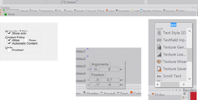

Ventuz 4 don't handle UHD screen for workspace
Font scale : 200%
Desk resolution : 3200x1800 px (14" screen... the New Razer Blade !)
Any solutions ?

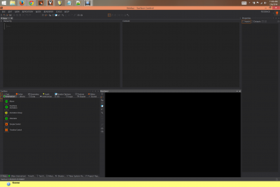

Re: Ventuz 4 don't handle UHD screen for workspace
is that windows 8?
I have be using the surface pro3 and and have to adjust the "Size of items on screen" (use to be DPI in win7) to make it usable to programing. Most likely have to sign out and back in to see full changes. But when the text is usable for programming its hard to use as a touch screen.

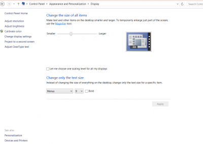

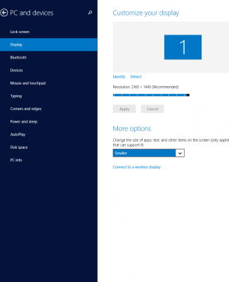

You want the set to smaller or closer to 100%.
Here are some screen shots from the surface pro 3 settings i am using for now.
-Sherman
Meru Interactive
Meru Interactive
