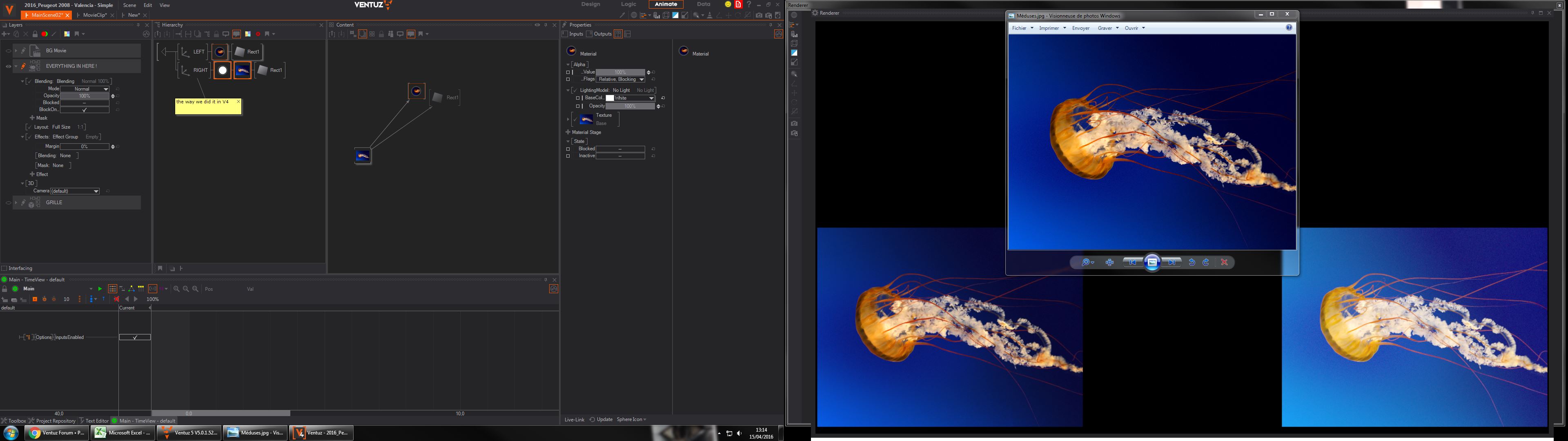

I'm making a show using the slide manager inside a 3D Layer with HDR (as I will need to bring some 3D inside the presentation) and I aslo have another 2D Movieclip layer for my background...
The problem is that I have light issues on images and videos. See attached files with my reference image. On the bottom left the image is with the new material node with no light / white the bootom right image is done using a copy paste from ventuz4.
So my questions is, how can I use only one slide manager controling everything inside one single layer : 3D with HDR, videos, images etc... ??
For example if I need to bring one image as a texture inside my 3D object with HDR, how can I avoid the brightness problem without putting my image on another layer in order to work easily with the slide manager??
Thank you,
Regards,
Olivier

Hi Olivier,
the old V4 Color and Material Nodes do not work properly in V5, especially in HDR Layers - because of the different Gamma which the old nodes are not aware of.
So in order to be able to work in the same Layer you will have to use V5 Nodes only. To replace the Nodes you may use the Scene Statistics Dialog (Menu Bar->Scene->Scene Statistics) which shows you all Nodes in your scene sorted by Category. Optionally filtered by deprecated Nodes.
Hope this helps,
Stephen

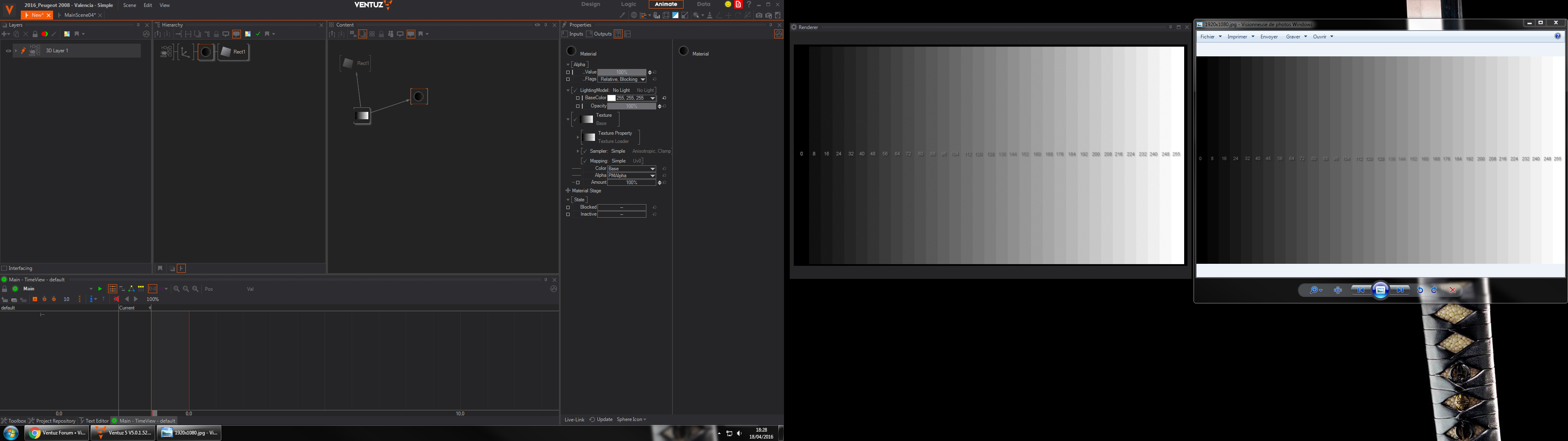

Re: Using a slide manager in Ventuz5
Ok for the video, it will be fixed
But for images also there is still a problem on 3D HDR layer even when using no light with base color white.
See attached picture with a color picker and compare the values...
Thanks,
Olivier
Thanks,
Olivier
Hi Olivier,
the Movie Gamma bug is fixed - this will be released with the next Ventuz Version (V5.0.2 or V5.1.0).
The Texture Loader has a Gamma Hint property. Setting it to Gamma 2-2 should fix this.
Regards,
Stephen
