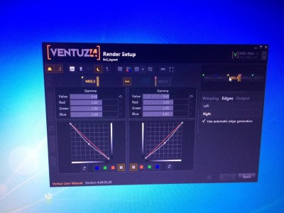

I met a problem is that when I use layout configuration to adjust Shaping, I can save the configuration, but it didn't work if I close the Layout Configuration.
Once I enter the Layout Configuration again, it works. But if I close it, it doesn't work again.But the Gamma value in Edge is the value I set before.
this is the value I set

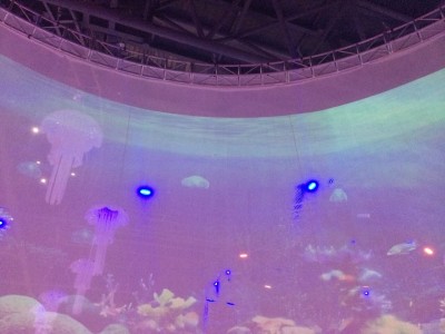

it works

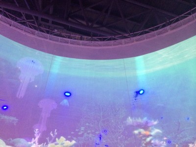

but after I save and close the Layout Configuration, it doesn't work.

We have discovered this already and prepared a fix.
We plan to release the fixed version (4.04.02) next Monday or Tuesday (7th or 8th July 2014).
As a workaroud, leave the AV config open all the time. As long as you don't actually change anything, it will not slow down Ventuz. Alternatively, try using the Gamma sliders instead of the spline editor, they should work.
