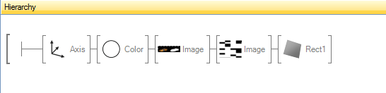

Re: image sequence as alpha mask
the easiest way is to use an image sequenz that has an alpha channel. In other words do not use images that are black and white, but use images that are white and alpha/transparent. If you then blend the textures by arranging the nodes as you see in the screenshot, you get the result that i guess you want.
Regards,
Götz
Regards,
Götz
