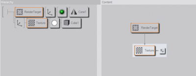

since I just started on learning the software, my problem may be easy to solve but I just do no find the solution. I'm just trying to understand the tutorial projects and so far everything is fine. Then I tried to just recreate the Tutorial and just wasn_t able to find out how I bind a Render Target to a texture of a cube.

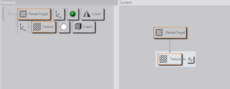

you can not bind a texture to a Cube Node directly. To apply a texture to a cube, put a Texture Node in front of it. The Texture Node has the Input Property called Texture to know which texture to apply. There you can bind nodes that provides a texture like Texture Loader, Live Video, Movie Clip.... or in this case a RenderTarget.
Select both, the RenderTarget and the TextureNode in the Hierarchy Editor using Shift+LeftMouseButton to see both of them in the Content Editor, so you can bind them.
If there is already a texture provider bound to the texture node, unbind it.
