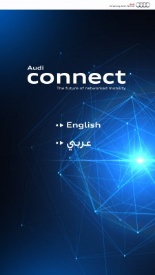

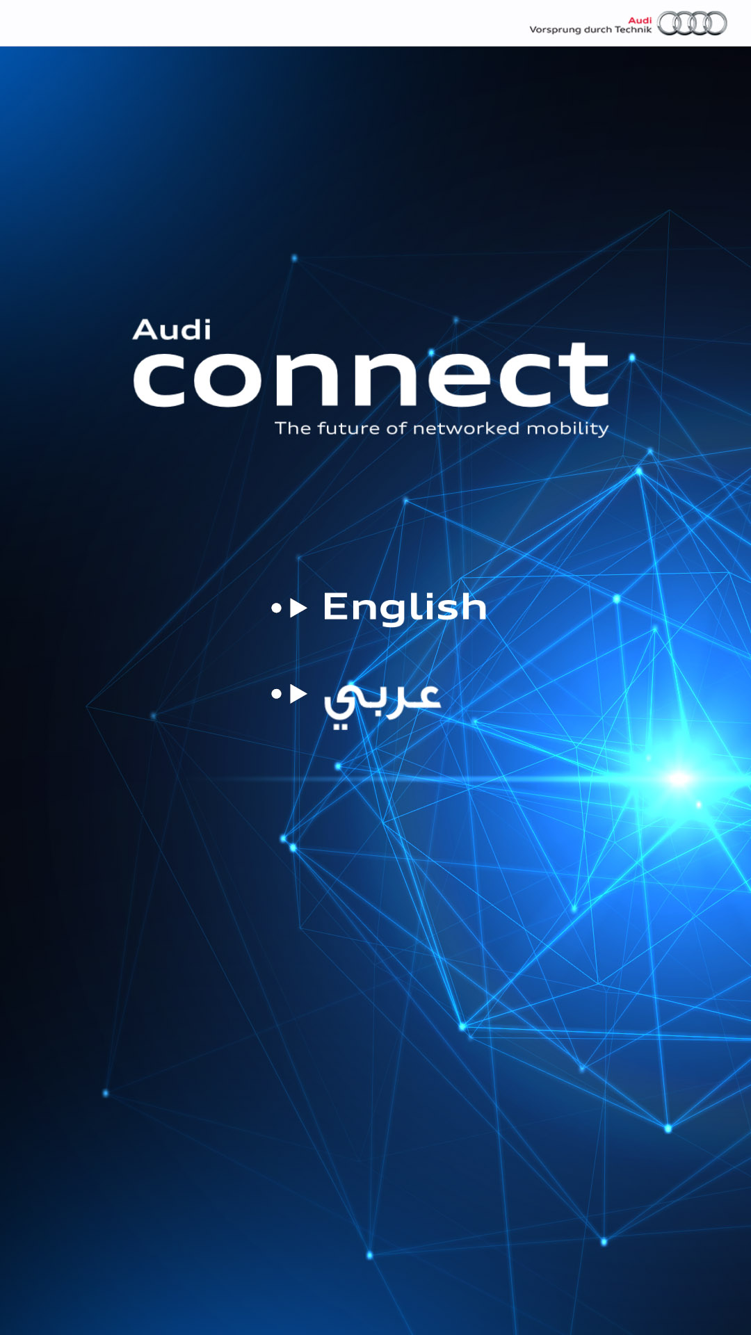

Use Cinema4D. Atomify a mesh to get this kind of structure with knots and connected lines. These individual objects you can animate without having to revert to mesh deformation or vertex animations. I just used this technique for a project extensively.
Have a look at what it can look like.
