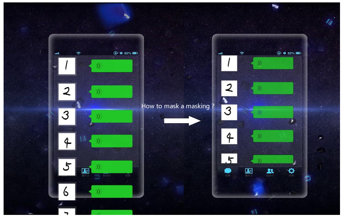

In my opinion,to do a mask effect in photoshop or flash is a very easy thing.However,I have no idea how to make a masking in ventuz,cause masking only works on texture.My application shows a short message list,so how to put the whole list behind the phone cover ?
An illustration is in below:

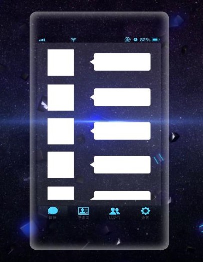

Thanks!! You remind me to use the Stencil Node in time.However,after I add Stencil Test node to my element tree,all of textures do not work,which are getting white!Daniel Willer wrote:Hey There,
There are actually to ways to mask elements in Ventuz. The first one is a so called stencil what means you define a Part of your Ventuz tree as an Mask and use it in another tree.
Check the UserManual to understand the Stencil nodes or press F1 on the Stencil node to get an interactive example.
By design the Stencil is a hard mask and can not be feathered. To do a "SoftMask" you can use a simple gradient texture with alpha.
Cheers!
Could you kindly help me to find the reason ? My project vza is attached.

Re: Masking Help
Hi Allen,
you used the stencil nodes reversed. You need to swap set and test. Additionally you need to respect the rendering order. There is a quick fix of your scene in the attachement.
Regards
Götz

Woooow!It works.Hi,you did a big favour.Thank you very much!Götz_B wrote:Hi Allen,
Regards
Götz
I think I need to make up the lesson of Stencil node as soon as possible.It's really a cute control.
