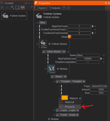

Ventuz Designer is crashing on trying to load Material from a property in Particle system Nexus renderer.
How to replicate:
Empty scene -> add Particle System to hierarchy -> in the default particle stream add Nexus renderer -> in either Triangles or Edges or Points try to change Material into Property -> crash.
Tested on Ventuz 6.12 and 6.11 both licenced and community, on different laptops and computers with Nvidia gpu.
