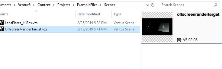

In Win Explorer activate the Preview Pane and click on the scene.
There will be the scene snapshot and version displayed.

Hey Robert,
Karol is right.
As soon as you enable the "preview panel from windows in the explorer".. it will show a snapshot and the version for the selected scene.
I dont have any additional shizzle installed..
you can enable the preview- (not the detail-) panel here:
regArts
PS: thats VERY handy tbh xD
Karol is right.
