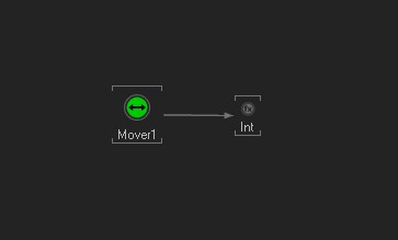

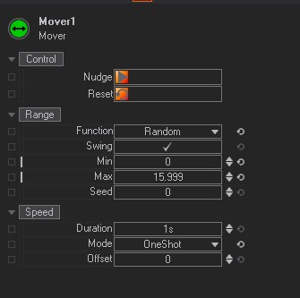

Re: I need to get random numbers from 0 to 15 in the output. Help me~T.T
Yes, the mover node is all you need.
You're writing numbers 0..15, so I assume you want integers and not floats, so 1, 2, 3, ... and not numbers like 3.14? See A) The Mover will give you floats - so we need to do an additional step here. If you 're looking for floats, see B)
A) you want integers 0..15
1. Add a mover node and set its Function to Random. Set the Mode to OneStep. Now you can trigger the Nudge event to generate a new random number. See attached image.
2. Set the Min to 0 and the Max to 15.999. This is important as explained below. [1]
3. Convert your float to int. This is done implicitely by passing the Mover's output into any input that is an integer. But we can also do this explicitely by using an integer Expression. Just add one and pipe the Mover's output into the expression's input A. Now you could put this into a content container, expose the nudge event and the integer expression's output. Bäm. [2]
[1] Why we use 15.999 as max: If you set it to 15, the mover will also generate the number 15. But converting the float to int will basically truncate the number. So anything in the range 0..<1 will become 0 - like 0.1, 0.6, 0.97. The probability is the same for 0, 1, 2, ... up to 14. However, 15 would not occur at the same probability, as we only have the exact value 15. We don't have a range 15..<16. By using 15.999 we give 15 (almost) the same range and therefore probability as the other numbers.
[2] An integer node would also work, but then we'd need to bind other nodes to the integer's input, as it has no integer output. Binding might bind to the changed event, so the workflow is more error-prone.
B) you want floats 0..15
