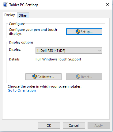

Have you tried selecting the correct touch screen in windows? Windows Button -> type Control panel, enter -> open Tablet PC settings -> click Setup -> follow instructions to select correct touch screen.Agalar Ragimov wrote: In my case, if I am using another screen as Main, touch sensors from the Dell touch screen works on that screen. For example, if my main screen is Wide LG screen and I am touching my Dell screen on the left top corner it is showing touch on the left top corner of the Wide LG screen. I have no idea why it is happening. Everybody who had same setup as mine in our company faced same touch and full-screen issues

Re: Full screen problem!
OMG. It works now. All this time I was facing that problem and the reason why it didn't work for me because I made that "Setup" while my Main screen was Dell Touch and not Wide LG screen.lerou wrote:Have you tried selecting the correct touch screen in windows? Windows Button -> type Control panel, enter -> open Tablet PC settings -> click Setup -> follow instructions to select correct touch screen.Agalar Ragimov wrote: In my case, if I am using another screen as Main, touch sensors from the Dell touch screen works on that screen. For example, if my main screen is Wide LG screen and I am touching my Dell screen on the left top corner it is showing touch on the left top corner of the Wide LG screen. I have no idea why it is happening. Everybody who had same setup as mine in our company faced same touch and full-screen issues
It looks that choosing touch display under Display options is not enough.
Thanks lerou for help.
