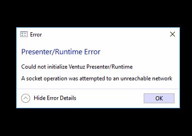

Just had to roll over to a backup machine on a show that was recording today because of a strange ventuz error I have never seen before!
"Could not initialise... A socket operation was attempted to an unreachable network"
It seems to have happened following a windows update.
We are running windows 10 and Ventuz5.3.1 broadcast.
Anybody seen this before???

I've seen this too on my development system. It had Hyper-V installed with a virtual network. After deleting this network as I wasn't actively using it, Ventuz was able to start again.
Could very well be something that changed with special network stuff in a recent windows 10 update as I think I've had this Hyper-V setup for a while even when running Ventuz on this system.

Great thanks Sander. I did have a usb network adaptor plugged in when the machine received its win10 update but it was unplugged when I had this error the machine is now stuck in studio running other software for the show so I can't try anything else at the moment.
Hopefully useful to flag to Ventuz though!?

we are aware of this problem but don't know the real reason for it.
But we can avoid the crash by catching the exceptions -> V5.3.2
