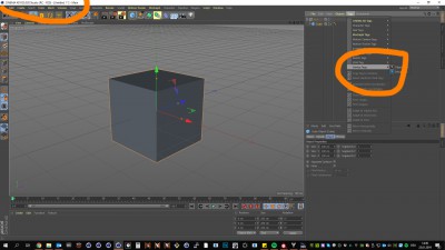

Is it me or did the Ventuz-Tags (that just got an update with 6.3) move to an unknown different place?
R19 and below working as usual.
I installed it with the tool found in the Ventuz Technology Directory. And it looks like it is present inside the PlugIn Folder.
Cheers.
6.3 and Cinema4D R20
