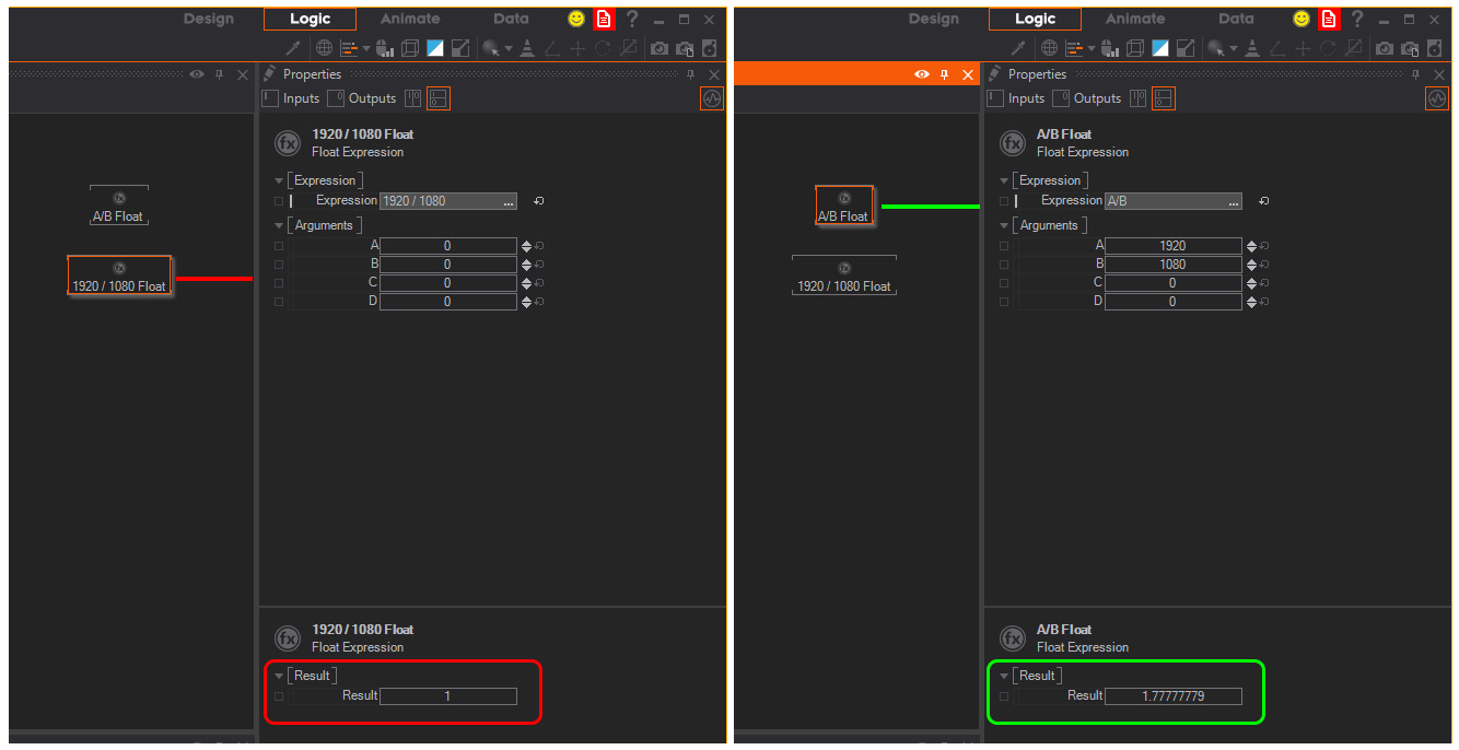

I encountered a bug with the float expression node. please see attached screenshot.
If I use numbers (1920/1080) instead of the variables (A/B) in the expression : I get integer instead of float in the result output.

that's not a bug. If you're writing
Code: Select all
1920 / 1080
you're using integer - the result will then be cast to float - after it's already truncated. If you're using the parameter fields - they are defined as float, so they are implicitly cast to float. You could do:
Code: Select all
1920.0f / 1080.0f
to use floats or
Code: Select all
1920.0 / 1080.0
to use doubles (the result will be cast to float).

Ok, I was unaware of that.
Thanks :)

But what is not realy consequent is, that 10/A is possible ;)

chriss0212 wrote:But what is not realy consequent is, that 10/A is possible ;)
That is because input property A is explicitly defined as float.

It is super consistent - IF you know that the input field is basically interpreted as C# code. And in C# the casting behaves as it does in most languages :)

i haven't said, that it is not consistent! It's just not easy to understand for a beginner that A/B is ok even if A and B is an int, but A/10 is not allowed ;)
I am really happy that Ventuz is doing all the conversions by using nodes... but i think a lot beginners (and sometimes me too) would be happy, if an int used in a expression would be converted too ;)
For the moment i can't see any disadvantage because in both cases the expression node is dealing with 2 integer's. But maybe there is?

I get your point, I do. Two reasons to keep it this way:
1. it's like in coding languages, so every coder knows. I'm a coder, so I'm biased ;) I know that beginners find it more difficult. BUT: You should always use the inputs - that's just cleaner than typing in 1920/1080 :)
2. To achieve your behaviour, Ventuz would have to write their own parser/compiler. Currently they most likely don't and just use C# - which is the better solution (far safer in terms of errors and standard behaviour).
But again, I get where you're coming from.

Rou is right!
And he listed the arguments why we won't change this behaviour.
