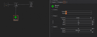

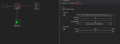

I have a *png sequence with *151 png files. I connected Mover node to the the Frame inside Movie Frame node. Mover is running from 0 till 150 but actual picture stops at 140

Mover properties
Movie Frame properties
