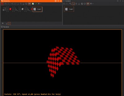

I tried it out, but it's not a render point as it used to be. :(

Post by Götz_B » 20 Oct 2016, 15:36
Yes, it changed a bit
http://www.ventuz.com/support/help/late ... solateMode
In contrast to Ventuz 4 or earlier versions the render engine is not starting to traverse the scene tree at the selected node. The whole tree is traversed but meshes outside the isolated subtree are skipped.

I don't get it. In the attached example I can put the render point on any node, the result is always the same. The good thing about the render point was, that you could easily check out your result at any stage - so in this case without the texture or without the color. Am I doing it wrong?!

Post by Dennis » 21 Oct 2016, 09:11
Hey Rou,
its correct.
In this case the Material and Lighting will be applied as well.
its more or less like the position of the selected object will be put in the center, you can rotate the object or the environment around.
The idea is to have the object seperated from the rest of the scene .. but still keep the lightingconditions.
It should be possible to "deactivate" the materialstage if you want to have it "pure".
