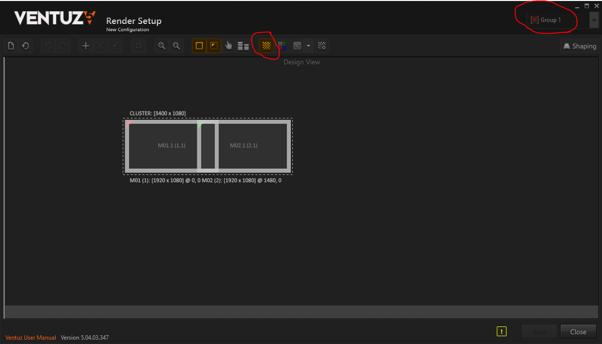

Hello,
Maybe I missed something but I'm not able to display a pattern on the whole machines group using the Ventuz Configuration Editor.
Is it normal ?
Regards,
R
Warping pattern on the whole machines group
Re: Warping pattern on the whole machines group
this should work. Check the log for possible warnings. Make sure the Machine IDs you set up match the IDs used in the render setup: the number in the paranthesis like M01 (1). If there's a mismatch you get this behaviour.
