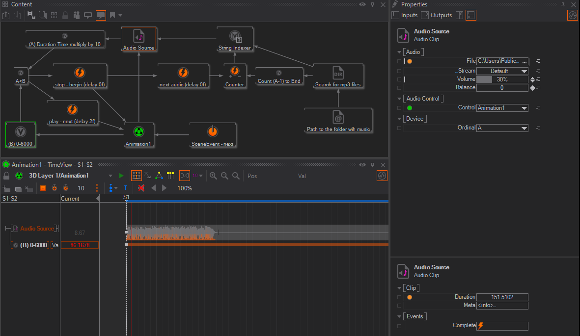

Animation node could be a solution for your question.
Check the image below.
The number '6000' I took just as an example. You can take any number but it should be much bigger than the 'duration time' of the longest audio file you can get from the client.
P.S. If you found out a better solution, please share.

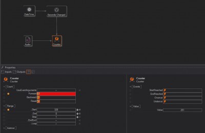

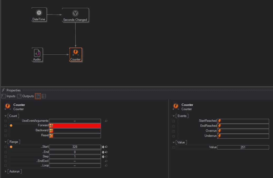

I found a solution by using the DateTime node and bind the "seconds" property to a "variable" node. The "changed" event of the "variable" node triggers the "forward" (or backward) property of a "counter" node and the "start" (or end) value to the duration of the audio clip node..... See attachment

I like it. Good and simple solution.Total-Image wrote:I found a solution by using the DateTime node and bind the "seconds" property to a "variable" node. The "changed" event of the "variable" node triggers the "forward" (or backward) property of a "counter" node and the "start" (or end) value to the duration of the audio clip node..... See attachment
