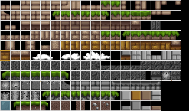

Post by Agalar Ragimov » 25 Mar 2018, 07:38
Another way to optimize your project is to create sprite sheet texture out of photos on iPad. It could be done by programmer.
You can use Mapping: 2D StripMapper and run through all of them using one single image. Also, if you can save the sprite texture in *DDS format from iPad on computer it will help in optimization and run app smoother than using *JPG or *PNG.
Kind regards,
Agalar Ragimov
Example of the sprite texture in the game industry
