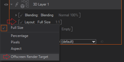

You can switch any layer to become an "Offscreen Render Target".
Simply click the "Layout" in the 3D Layer
then choose "Offscreen Render Target" instead of "Full Size"

Fantastic! Thank you.
I didn't think to look into layout properties for that. :P
