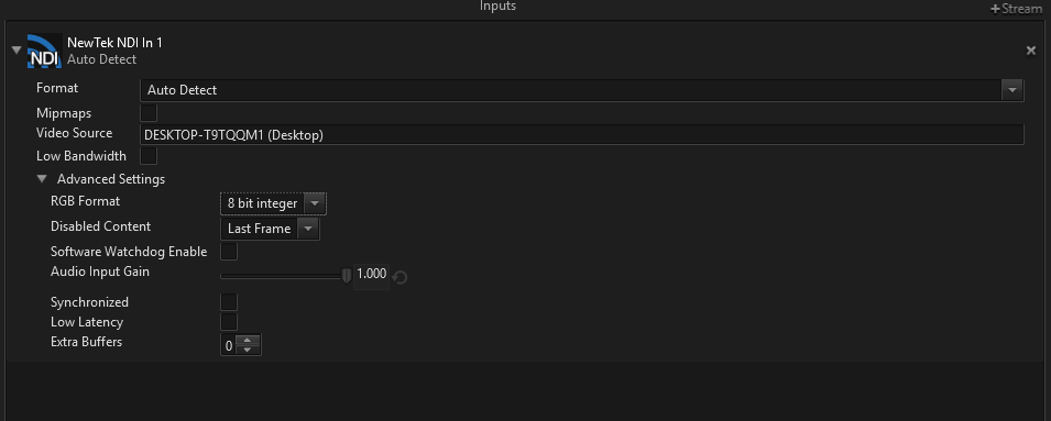

Hi Stephan,
are you sure, that you have used high quality setup in config editor?
I just made a small test and it was not that bad!

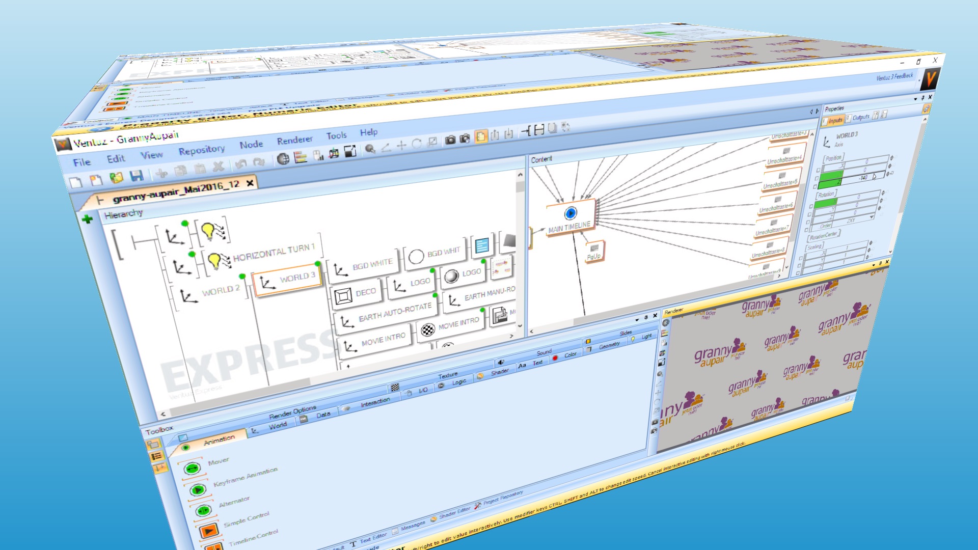

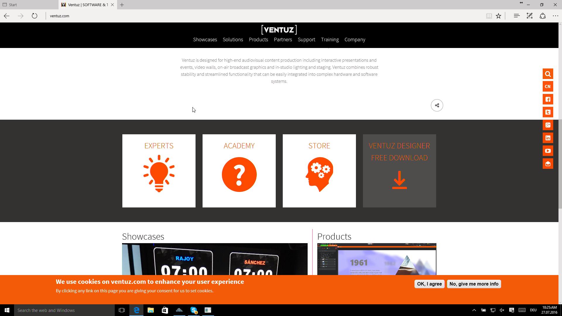

Same Ventuz-Config for both tests: see snapshots below Chris (inserted V3express in V5
Version 2 is significant better.
1. NDI Newtek Scanconverter 2. NDI vMix Greets, Stephan

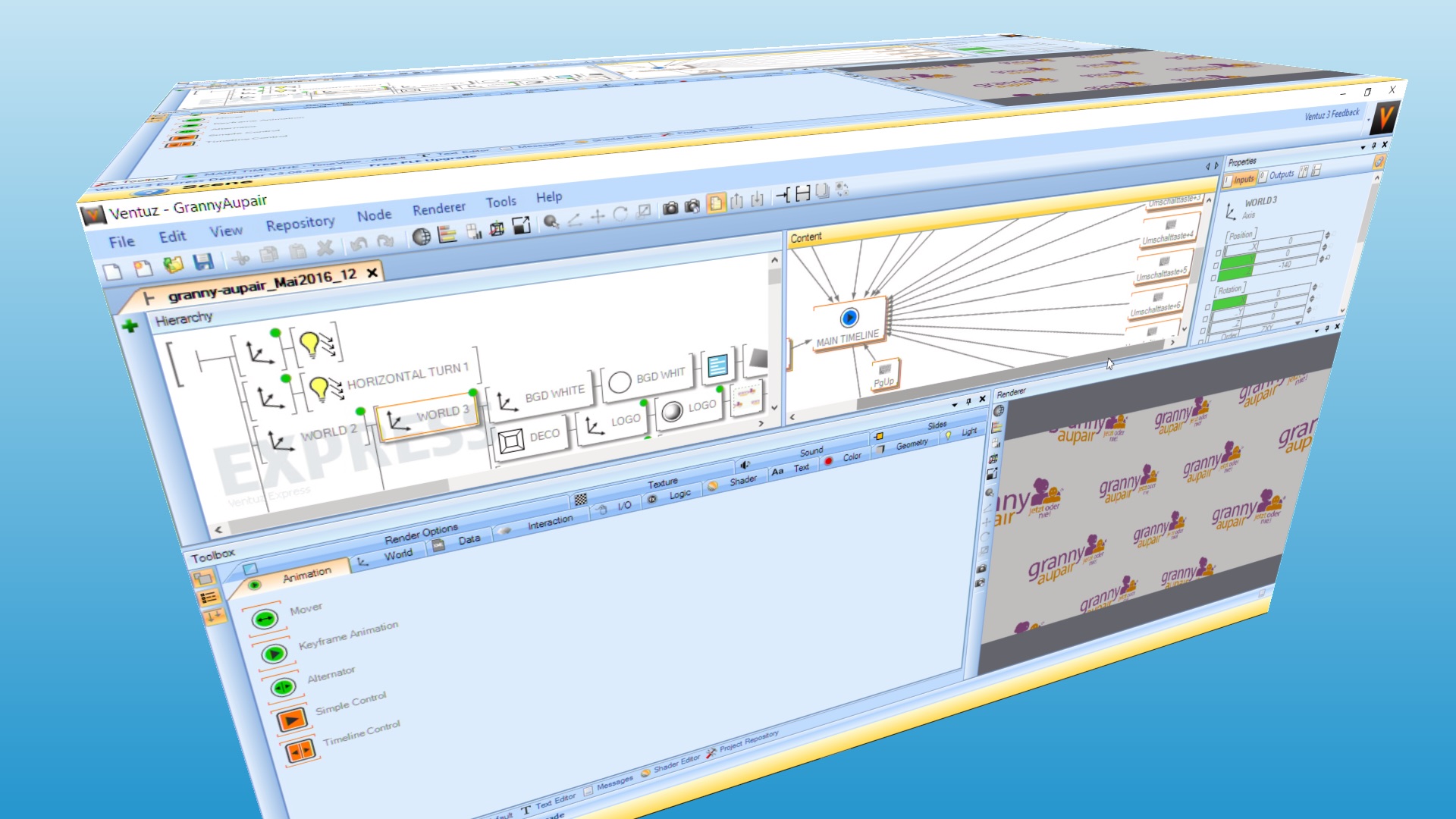

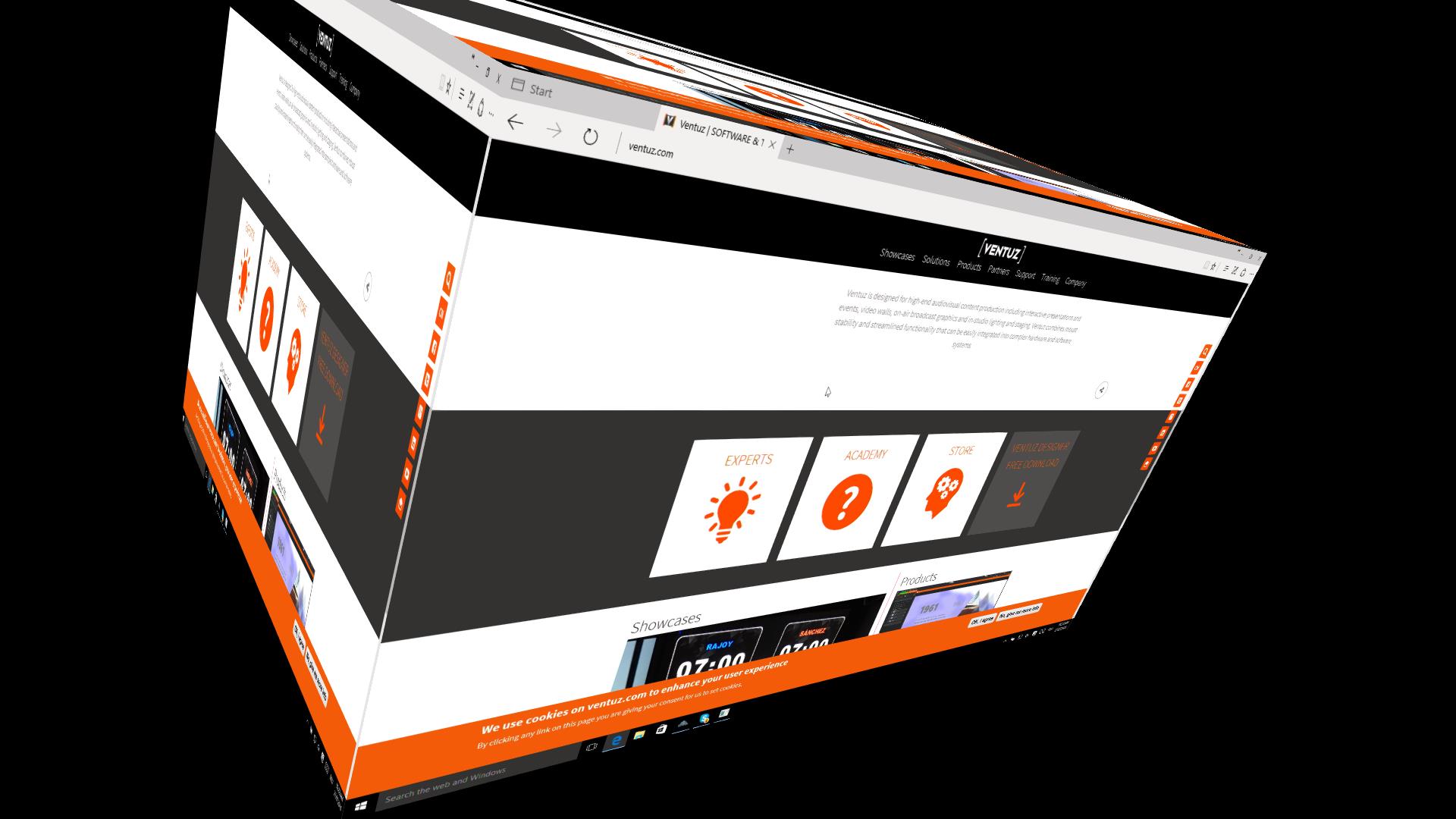

Hi Stephan,
looks realy ugly on your site. On my system it looks much better! I have one Snapshot without scaling and one scaled on a cube
Greets
Christian
Greets
Christian
