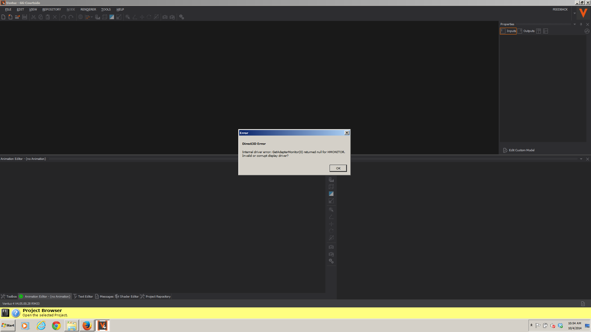

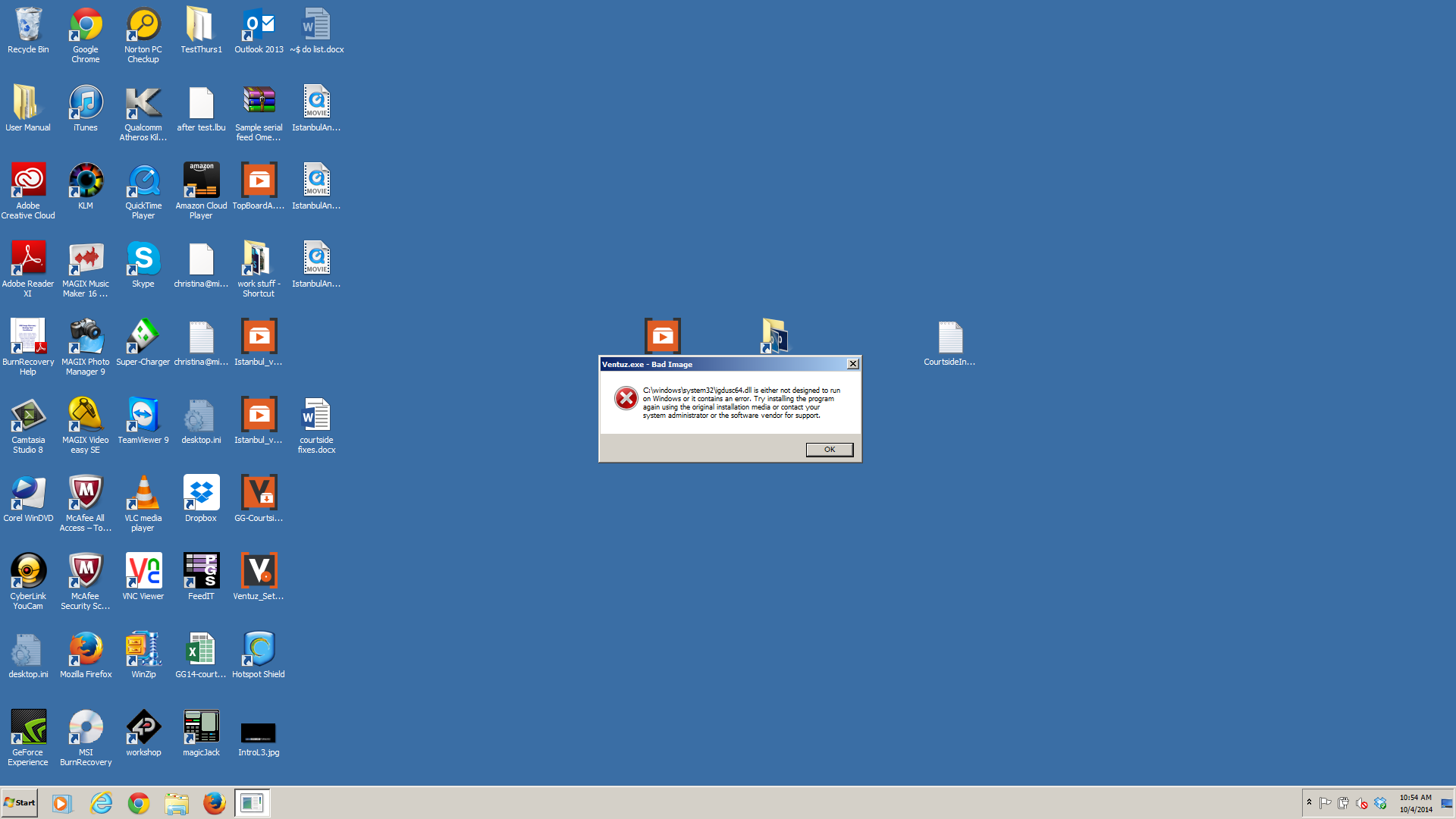

I've upgraded to 4.05.00.28.R433 and it was working for a day or so, but now I get these error message. Has anyone else see this? Any suggestion to get it fixed and running again.

What did you change on your system after the installation of Ventuz 4.5?
If it was running for a day and then stopped, your computer system must have changed somehow.
Did you install or removed any other software on you computer?
It seems that Ventuz cannot initialize any graphics device (DirectX) anymore. This 'igdusc64.dll' seems to be part of the Intel Graphics Driver Dll.
You could try to update this driver.
