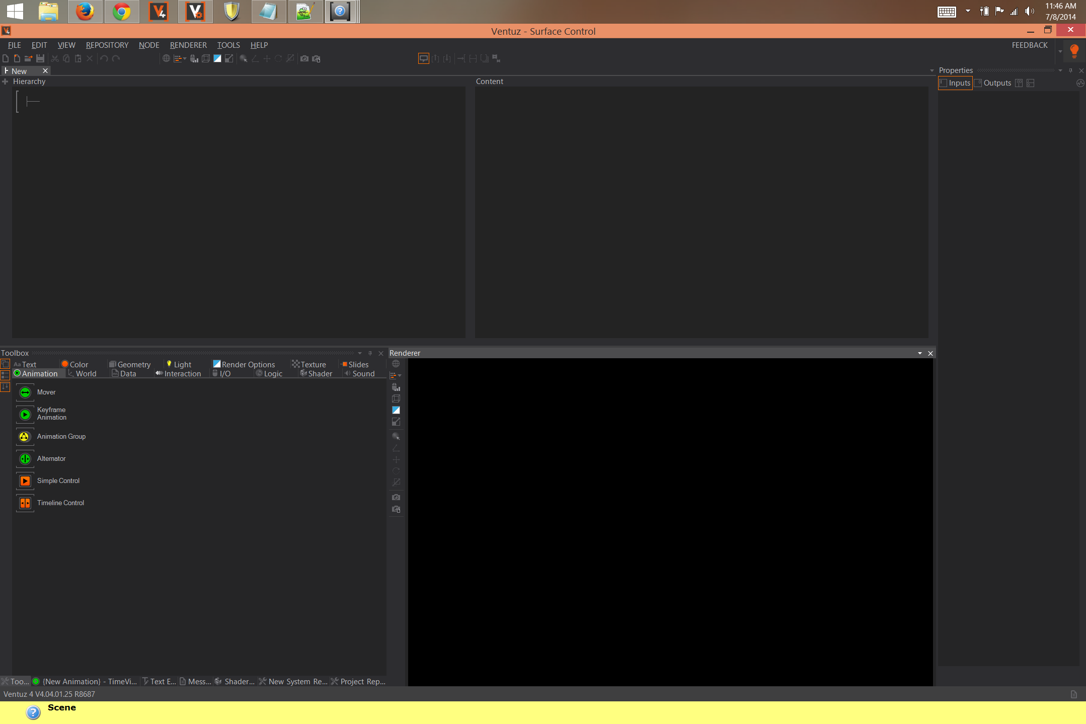

Post by shermanpat » 08 Jul 2014, 18:52
You want the set to smaller or closer to 100%.
Here are some screen shots from the surface pro 3 settings i am using for now.
-Sherman

Post by florian » 08 Jul 2014, 20:29
Great, thanks for the screenshots
Not very good on Ventuz but we'll make it work with these parameters
Hope Ventuz team will take a look on it
Thanks !
