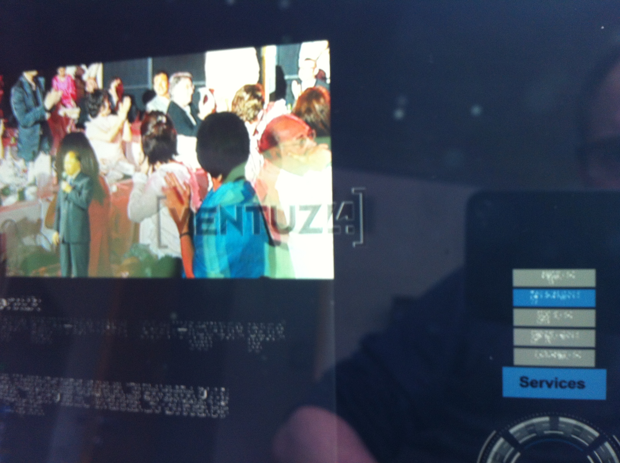

Hi there.
I've got the Problem, that on a mobile device (asus transformer book), which had no problems under Ventuz 3, the text textures seem to be buggy! (see attached pic// the text "Services" is visible because of beeing a mesh loader)
there are some issues in presenter log, too. may they cause this problem? and how could it be solved??? is it only of the low performance of the book? coming back: under Ventuz 3 there are some performance problems, like stuttering animations and laggy video, but never appeared texture failures!
14:35:51.0 Warning: TexText3 (Texture Text (deprecated)) Resource Static Font took 51ms to create and may caused rendering stalls
14:35:51.3 Warning: AdvImage (Texture Loader) Resource Texture Loader: ./Images/1_Service/1_4_Produktion.png took 300ms to create and may caused rendering stalls

hi daniel and thx for the quick reply.
tried it but no effect
I'm using 4.03.01 752
diezweiundvierzig
Re: Problem with Text Textures.
edit:diezweiundvierzig wrote:hi daniel and thx for the quick reply.
tried it but no effectI'm using 4.03.01 752
same effect appears if I open that scene in Designer - but only on that machine! ?!? confused...

it's diffucult to argue if it's about the font or the performance of the PC itself. But on V3 everything is fine (exemt from the performance itself).
on a simple-scene with only the text textures, all is fine (see pic).
embedded in the Scene (via ScenePort) it's the curious effect, that every text node is broken, except the new embedded?!
