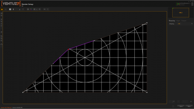

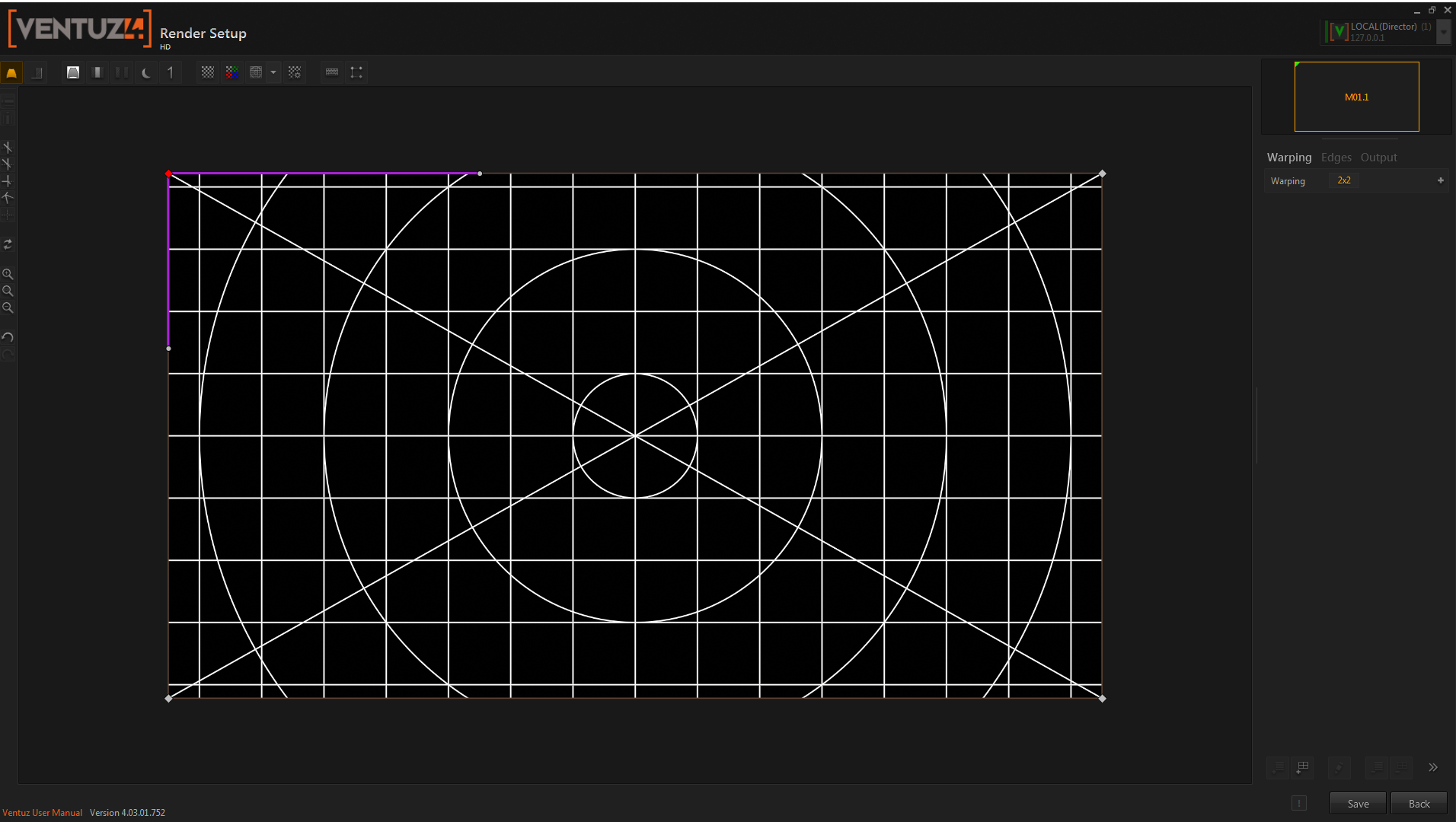

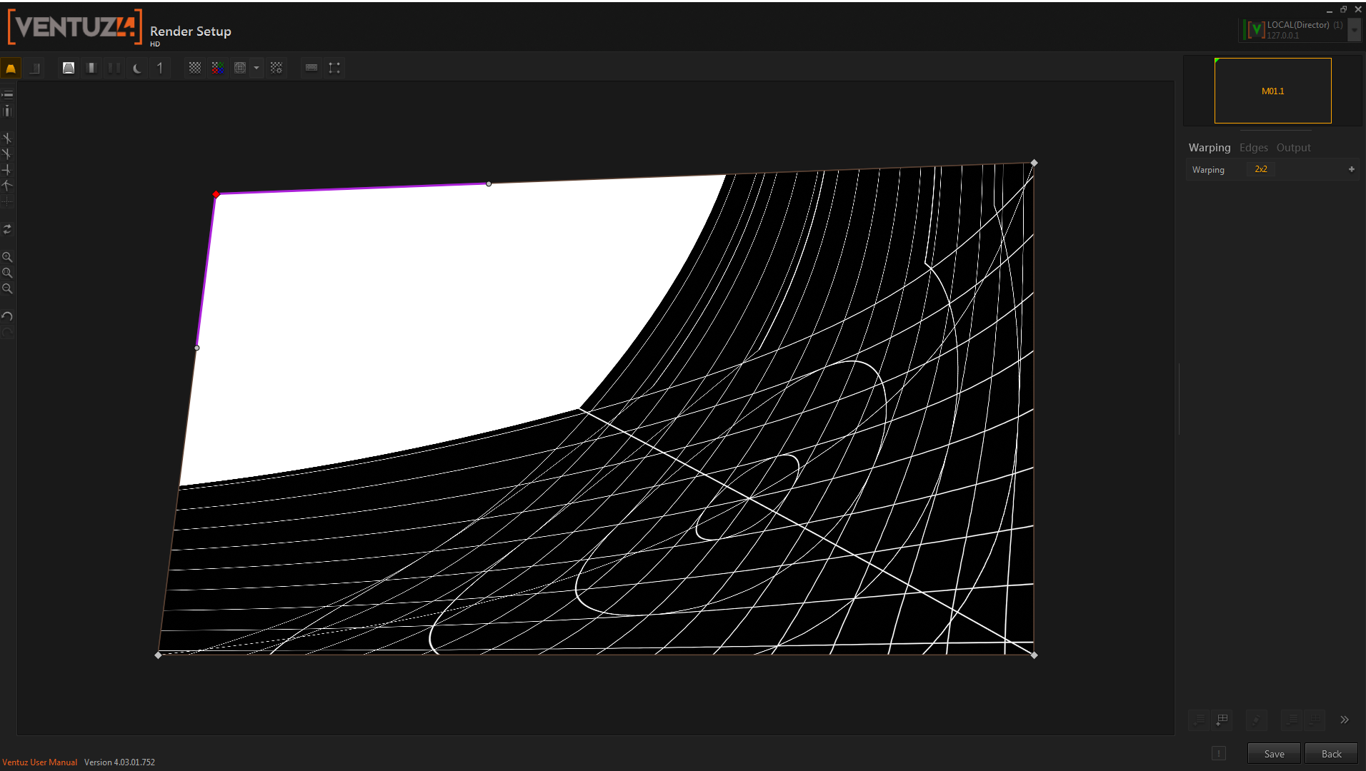

Hello,
When I move a point without warping from an inner position the shaping is moving.
Step01
Step02
Step03 ??

I can reproduce this and will investigate.

will be fixed in Ventuz 4.03.02.
The problem that was fixed occurs when using "move without warping" to move an edge point outwards.
Please note that the method we are using for the "move without warping" feature gets more imprecise the more "warped" the image is around the moving point.
But that is not the case here, nothing is warped at all, this should have worked. And now it does :-)
