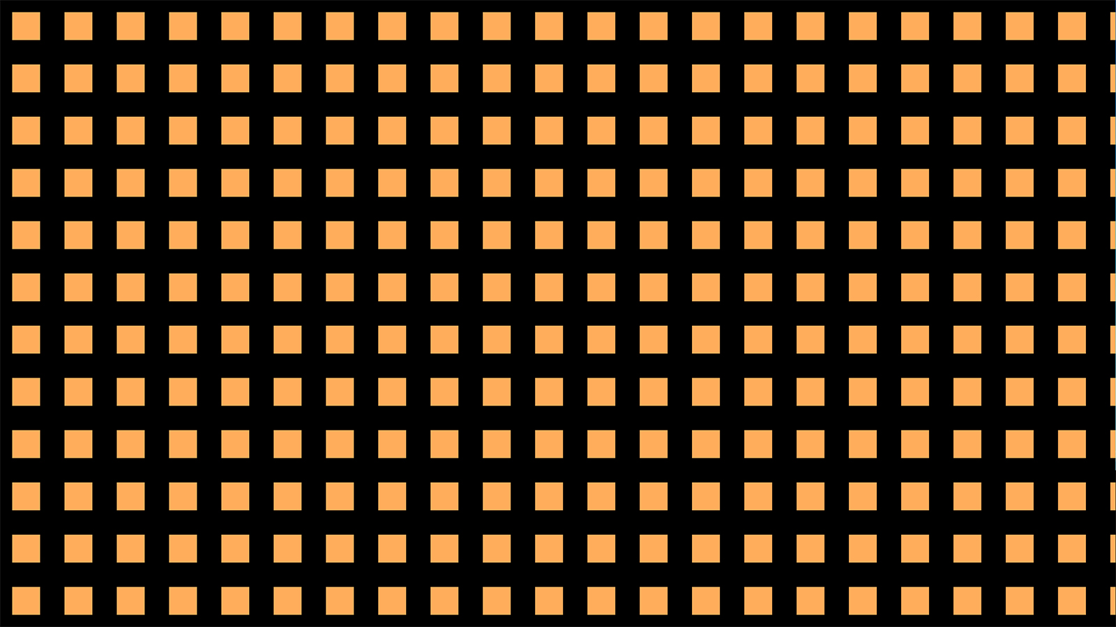

Ventuz 4 Runtime loader doesn't show the presentation as I see in Director.
During the loading process the screen is filled by many orange boxes that enlarge: what's that??? (horrible)

I tried to reproduce your error, but works fine here.
The orange boxes represent the loading process. So looks like your vpr gets stuck during loading.
Do u get any error messages? Have a look in the presenter log file ( \Users\Public\PublicDocuments\Ventuz4\Log\presenter.log).
