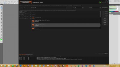

Attached is a screen shot of the Configuration Editor with it's log expanded. This is what it looks like after I've selected either "Telogis Ventuz Test (Telogis Ventuz Test.vzp)" or "Telogis Ventuz Test (BKG.vpr) from the "Live Project Management List," clicked the "Upload" button and selected "Telogis Ventuz Test.vpa" from the resulting browsing box.

In your screenshot I see you selected your local machine - in the drop-down on the top right.
If you want to upload it to another machine, you have to select that machine (or a group if you like to upload it to multiple machines)
