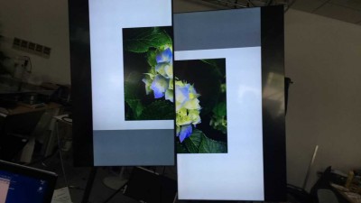

I've tried to render a simple output with my video walls at a simple offset. However I could not seem to achieve it in real life. Anyone here knows what seems to be the problem?
Problems with Render Setup on Video Wall

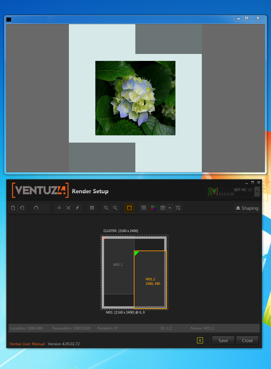

Set your machine ID to 1 to match the RenderSetup.
If you have a look at your Render Setup, you see M01. That means that this part is rendered by the machine with ID 1. Your machine is set to ID 0. When the machine doesn't find anything that matches its ID, it shows the so called Cluster Preview, which is a Design Preview of the complete scene. When it matches, you'll see the production output.
