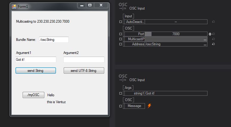

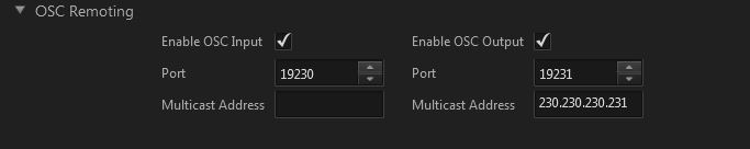

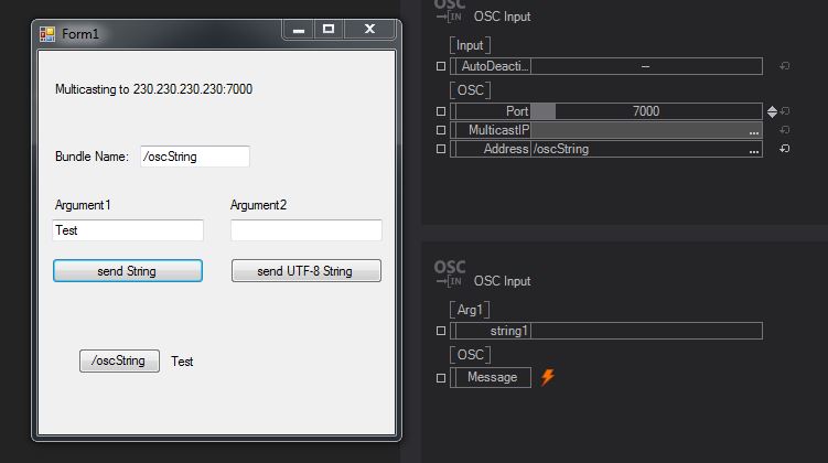

But how can i get this Windows form work together with the buildin OSC-Nodes in Ventuz?
I have tried to setup up a Ventuz OSC-In Node to receive from the windows form, see pics
The original Project was build with Visual 2008, I have converted to Visual 2012, because I need some async operations.
Do i miss to setup the correct ports?
tia, joschy
Ventuz Config
OSC Out Node
OSC In Node

you have no ip int the osc nodes! so if you send to ip 230.230.230.230 what is a multicast adress you need to make sure, that you adjust the osc in node in ventuz to this adress!

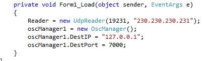

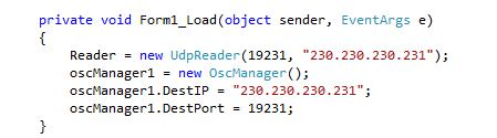

and the osc manger code
multicast ip adress
osc manger

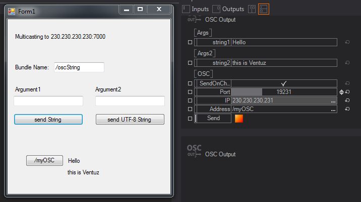

Got it to work :)
