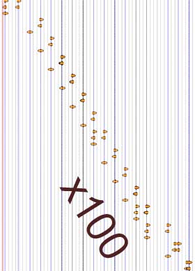

last week i moved thousands of keyframes by hand :cry:
Please, implement a feature like 'select all keyframes from time to ...' (by including the sometimes hidden subkeyframes!)
This would be very very helpful.
stephan

stephan
non-creative job to move all by hand
